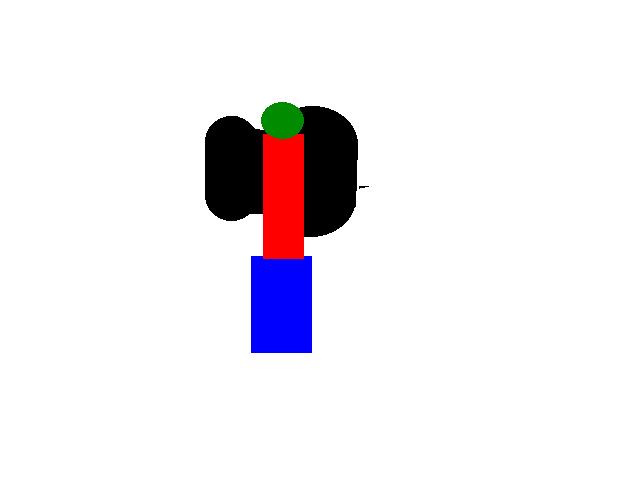

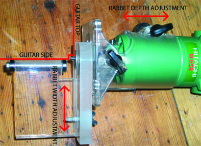

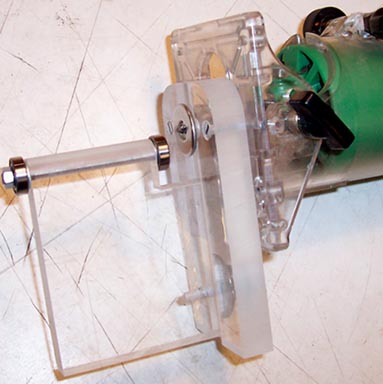

I'm not exactly sure how the binding jig from “Guitar Jigs” works, but as I understand it's a double bearing foot or base that registers off the guitar's sides and on its top or back edge. I used this principle when I made one out of 15 mm Plexiglas scraps that works very well for me. The binding rabbet width is adjusted by moving the bottom part in or out in groove in the top part. A wing nut and a screw that is tapped into the moving bottom part secure it to the fixed upper part. The binding rabbet height is adjusted on the trimmer base adjustment screw. I like the fact that I can use 1/4" carbide down cut bits (from LMI) with this jig, so the cut is very clean. The bit protrudes through a washer glued to the base which makes sure you only register on the edge of the top or back plate, meaning the plate’s radius will not interfere with the cut. I clamp this jig in a vise and rotate the guitar. From the descriptions by Josh and others above you need to be aware of many of the same things that you do with the “Guitar Jigs” trimmer with this one, but this one is a lot cheaper! Hopefully the picture explains better than my words...
Arnt38602.2740046296

Great looking Jig!! Yes you are right, the guitarjigs jig and your jig work by the same principle. I think it would be great if you could submit a few more pictures and a description and get Lance to put it on the Jigs page of the forum.

This is just a humble jig, based on about a dozen different designs I have seen in the MIMF archives and elsewhere around the internet. I'm sure the Don Williams or LMI ones are more fool proof, but like I said this one works so well for me that won't bother with one of the more elaborate ones (yet!).
I made this quick illustration of how the thing works, I don't have any pictures of it in action. I usually cut first from the widest part of the bouts towards the end block, neck block and waist, then one or two passes around the entire instrument. There's usually little to no fuzz to clean up afterwards, and the rabbet is remarkably even!
<edit> something wrong with picture, it seems... It's a .jpeg of 79kb...can't seem to fix it...hmmm Arnt38602.6419560185
